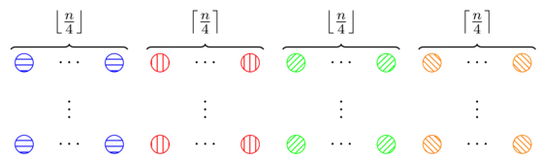

Example
Consider this coloring (which roughly corresponds to an algorithm I have investigated):
example coloring
[source]
For edges as implied by the Levenshtein distance recursion, that is
$\qquad \displaystyle E_n = \bigcup_{1 \leq i,j \leq n}\{(i,j)\} \times \{(i-1,j), (i-1,j-1), (i,j-1) \} \cap \{1,\dots,n\}^2$,
we have $D_n = 3$ and $C_n = 8n-4$, so this is not the $E_n$ we are looking for. If we draw edges from every node to all others to its right, that is
$\qquad \displaystyle E_n = \{ ((i,j),(i,j')) \mid j' > j \}$,
we get $D_n = n-1$ and $C_n \geq \frac{3}{4}n^2$, so the coloring is defeated.
