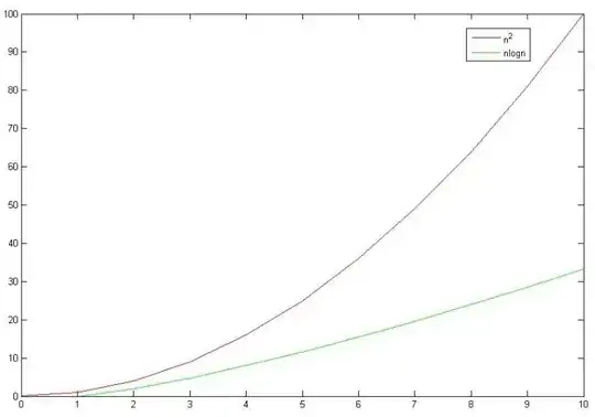

This is actually a mathematical matter and not the matter of the worst case running time. First you have to know that Big O does not represent worst case running time of some algorithms. Big O comes from mathematics and it represents an asymptotic upper bound for some mathematical functions.
You can see that the graph of $n^2$ is always above the graph of $n\log n$. so you can say $n^2$ is an upper bound on $n\log n$ as the value of $n\log n$ is always less than $n^2$. So mathematically you can say $n\log n=O(n^2)$. Similarly graphs of all $n^i$ for $i\geq 2$ are always above the graph of $n\log n$. So you can say $n\log n$ is also $O(n^3),O(n^4),O(n^5),\ldots$
But one thing you have to remember that though $n\log n$ is $O(n^2)$ but $n\log n$ is not $\Theta(n^2)$, because $n\log n$ is not $\Omega(n^2)$. Mathematically you can say $n\log n$ is $o(n^2)$.
