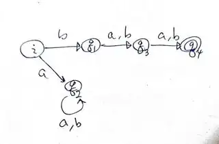

I'm new to automata and in my first exercise I have to construct a DFA that starts with 'b' and length=3. Two symbols (a,b).
To my understanding, there are 4 possibilities {baa,bab,bba,bbb}
I have attached a picture showing where I got stuck. Any help is appreciated, also please tell me if the part I've already done has errors.
https://postimg.cc/7JPNyRVq

Hint 1: Every state in a DFA "remembers something", for example, in your attempt, the state $q_1$ remembers two things: (1) that we've just read $b$, and (2) that we've read a word of length 1 so far. Now if you want to accept all words whose length is exactly 3 and start with $b$, then:
1- What would you do from the state $q_1$ upon reading a letter?
2- What would you do from a state, to be added, that remembers that we have read a word that starts with $b$ and whose length is 3?
Hint 2 (more general): All words over $\Sigma = \{a, b \}$ of length $\leq k$ for some constant $k$, can be presented as a finite full binary tree whose depth is at most $k$, where the root corresponds to the empty word, and if a word node $n$ corresponds to a word $w$, then its left child and right child correspond to the words $wa$ and $wb$, respectively. Think how you can define a DFA for your language on top of that tree. In fact, this hint can be used to show that every finite language is regular.

How about creating an NFA with Thompson's construction, and getting the equivalent DFA with powerset construction? Here's how it goes:
First, a regular expression describing a language consisting strings with length of 3 and starting with $b$ would be $b(a|b)(a|b)$. Use Thompson's construction to get
NFA
In this case, the automaton is already deterministic, so therefore, powerset construction is not needed, and you got the automaton you want.
