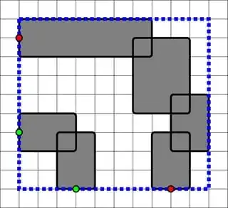

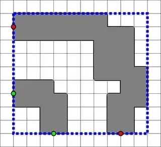

4X3-gadget
This gadget has two valid minimal-square-partition-states:
enter image description here         enter image description here         enter image description here
LeftA 4X3-gadget.Middle and right:Two possible minimal-square-partition-states.

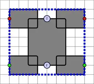

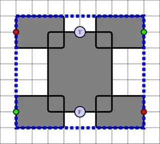

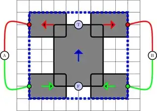

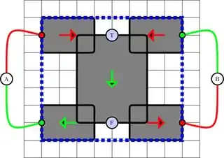

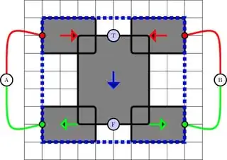

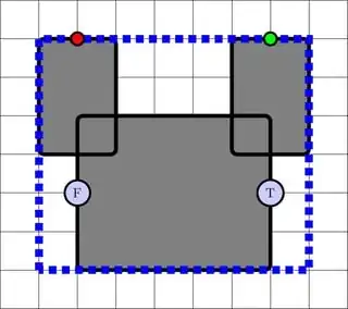

endpoint-gadget
An endpoint-gadget is a 5X4-gadget. It is frequently used as an endpoint/pin of a gate. One of the two states of an endpoint can be valued as true, and the other false. An endpoint marks the two ends, one as $T$ and the other as $F$. The end that is covered by the large square is the value of the endpoint.
Left: Wireframe of endpoint-gadget. Center:True-valued endpoint. Right: False-valued endpoint.

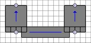

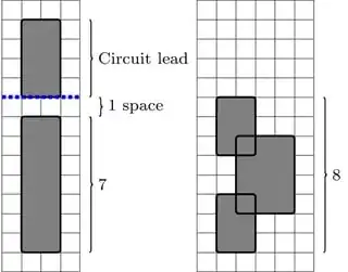

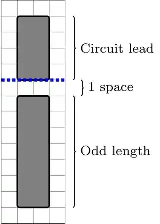

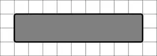

i-wire gadget
An i-wire gadget is short for implication wire.
Rules:
  • An i-wire gadget consists of a odd-length rectangle of a length of more than $2$ and a width of $2$.
  • An i-wire gadget can have $3$ minimal-square-partition-states, pushed from one side, the other, or neither; an i-wire in this third state shall be called locally unconstrainted.
Example:
Figure 7: An i-wire gadget of length $7$, and width $2$.

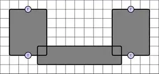

Here is how it is used:
Figure 8,9, Left: wireframe i-wire across two endpoints. Right: Union.

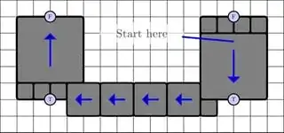

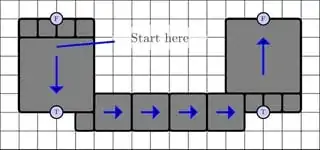

Now, if one endpoint is in the right state, it forces the other endpoint into a pushed-position. Example:
Left: Square partition diagram; left switch is down, "pushes" all the squares down the i-wire and finally, pushes the other switch (endpoint). Right: Square partition diagram; left endpoint is full, "pushes" all the squares down the i-wire, and forces the endpoint on left to be "up".
This is essentially a logical implication. Consider "down" to be true, then we have $A \implies \neg B$. We can also do $A \implies B$ by simply flipping the endpoint on the right.

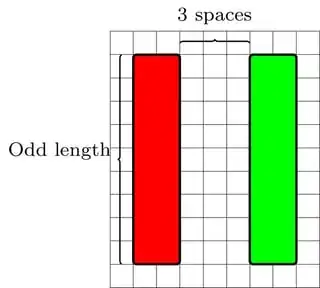

wire
A wire consists a pair of i-wires that are connected to the same gates at each endpoint.
  • The i-wires are colored red and green.
  • The pair must be separated by $3$ spaces (convention).
  • Each gate pin will have a green and red contact; a wire must correctly connect.
  • Invariant rule: one i-wire be pushed in the opposite direction of the other i-wire, each gate assumes this, and makes certain of this (unless otherwise noted).
  • Since each wire contains a two-way implication, it carries the values from gate to gate like a wire in a circuit.
  • Every wire must be connected to a gate at both ends.. Failing this can ruin the assumptions of some gates that I describe, and the invariant rule above; however, gates that have endpoints across the leads are safe - you can connect stray wires to these endpoints without worrying about it ruining the gate.
  • wires must be of odd-length, including the leads to any circuit it connects to; however I will describe an odd-skip-gate below that allows an even-lengthed wire to become odd-lengthed.

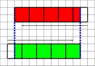

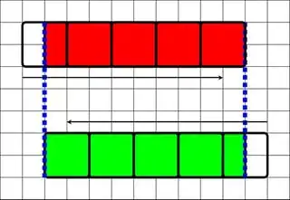

Pictures:
Above: A wire.
Left and right: Two possible minimal-square-partition-states of a wire. Note that if the wire is only this length, it will not be able to shift off to the right or left, and will have to break one square into smaller pieces.

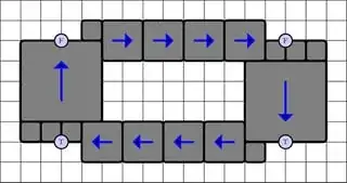

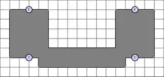

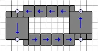

bend-gate: Bending a wire
Left: Wire-frame view. Right: Union view.
Note the use of the 4X3-gadget. It is used to fix the red lead to odd length.
Following are the two possible minimal-square-partition-states of the bend:
Left and right:Two possible minimal-square-square-partition-states of a bending wire.
The gate can be oriented as needed. Obviously, this gate can be mirrored to work for the other direction.

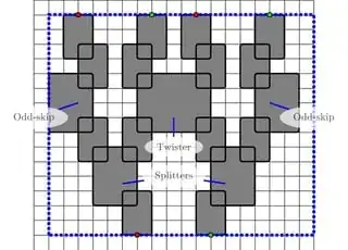

odd-skip-gate: Odd skipping a wire
Sometimes it is inconvenient to only have odd-length wires. For example:
As you can see, that little bit of extension is a bit annoying. Here is a corresponding solution, using the 4X3-gate:
So, turning this into a gate, we get the odd-skip-gate (in wireframe):

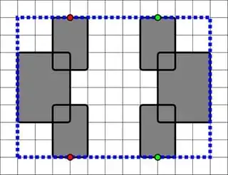

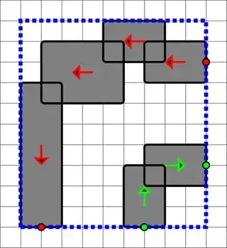

twist-gate: Twisting a wire
Somtimes you get the red and black i-wires on the wrong sides for use with a gate. In this case, a twist-gate is provided, to twist the red and black i-wires to the opposite sides.
Wireframe illustration:
Convince yourself it works:
Start from $A$, follow the push-arrows, everything else should be forced and consistent.

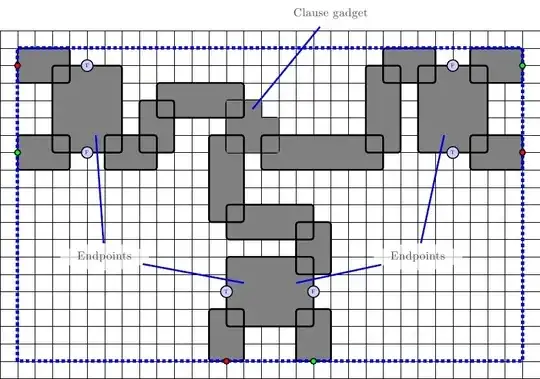

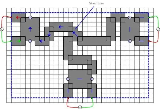

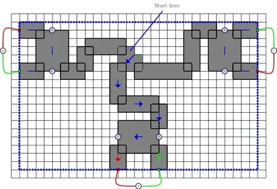

clause-gate

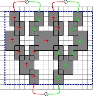

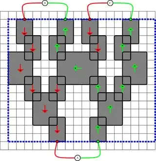

For the clause-gate, we first introduce the clause-gadget:
Left to right: 1 clause-gadget. 2-4: $3$ different minimal-square-partition-states.
This is what the gate looks like:
We can demonstrate the different states of this gate (explanation underneath all $3$ illustrations):
Explanation:
  1. Start at the clause-gadget and follow the arrows.
  2. Non-arrow-lines mean that it is part of a circuit, but it is not forced into a state by the gate.
  3. The state of the clause-gadget forces one of the endpoints to be valued true.
As you can see, at least one of the inputs will have to be valued as true. This is exactly what a $3\text{-CNF}$ clause requires.

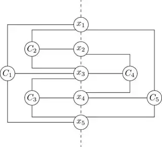

Let $\Phi(\mathbf x)$ be a $\text{Planar-}3\text{-SAT}$ formula, where
$$\Phi\left(\mathbf x\right)={\huge\wedge}_i^n C_i,\\ C=\left\{(x_j \vee x_k \vee x_l)\right\} $$
A visual aid (original source: Terrain Guarding is NP-Hard (PDF), reproduced in tikz):
Then:
  1. For each variable $x_i\in\mathbf x$, place two named-variable-gates next to each-other, name one of them $x_i$ and the other $\neg x_i$.
  2. Connect the gates to each-other with a not-gate, so that they logically negate each-other's values.
  3. Place the variables' gates' polygons at their locations in the planar-embedding.
  4. For each clause, place a clause-gate at the clause's location in the planar-embedding.
  5. Using the gates described above, connect all the variables to their clauses.
  6. Run a minimum-square-paritioning-algorithm on the resulting union of the all of gate's polygons (the entire circuit).
  7. If the algorithm returns the sum of all the gate's minimal-square-partition-state sizes (subtracting for shared-corners) then it is satisfiable. If it is not satisfiable, it will force a constrained gadget to split into smaller squares, thus increasing the number of squares required to partition the circuit.
