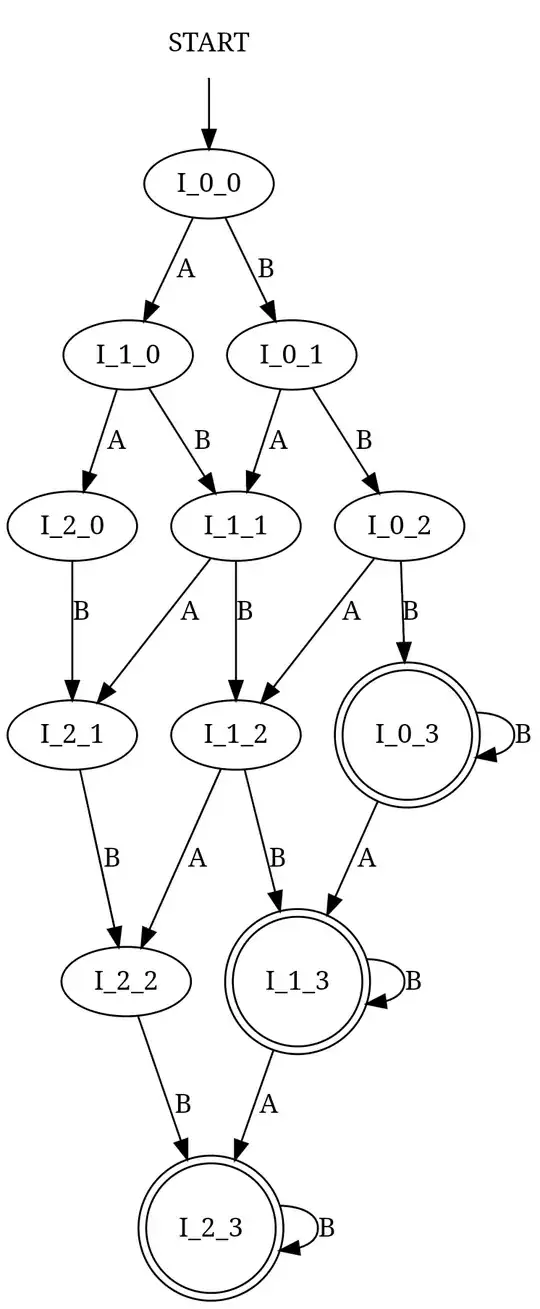

A regular expression can be developed from the following finite state machine for at most 2 As and at least 3 Bs by using all possible paths separate by |, and using * where their is a loop edge.
Finite State Machine
Resulting regex: AABBBB*|ABABBB*|ABBABB*|ABBBAB*|ABBBB*AB*|BAABBB*|BABABB*|BABBAB*|BABBB*AB*|BBAABB*|BBABAB*|BBABB*AB*|ABBBB*|BABBB*|BBABB*|BBBAB*|BBBB*(AB*)?(AB*)?
