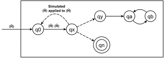

Applying a Simulating Halt Decider to the Linz Halting Problem Proof
A simulating (at least partial) halt decider correctly predicts whether or not its correctly simulated input can possibly reach its own final state and halt. It does this by correctly recognizing several non-halting behavior patterns in a finite number of steps of correct simulation. Inputs that do terminate are simply simulated until they complete.

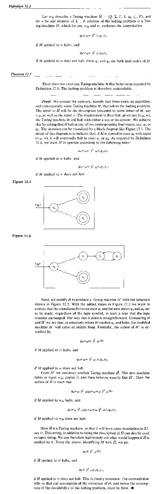

The Linz text indicates that Ĥ is defined on the basis of prepending and appending states to the original Linz H, (assumed halt decider) thus is named embedded_H.
(q0) is prepended to H to copy the ⟨Ĥ⟩ input of Ĥ. The transition from (qa) to (qb) is the conventional infinite loop appended to the (qy) accept state of embedded_H. ⊢* indicates an arbitrary number of moves.
The Linz term “move” means a state transition and its corresponding tape head action {move_left, move_right, read, write}. Ĥ is applied to its own machine description ⟨Ĥ⟩.
Ĥ.q0 ⟨Ĥ⟩ ⊢* embedded_H ⟨Ĥ⟩ ⟨Ĥ⟩ ⊢* Ĥ.qy ∞
Ĥ.q0 ⟨Ĥ⟩ ⊢* embedded_H ⟨Ĥ⟩ ⟨Ĥ⟩ ⊢* Ĥ.qn
When Ĥ is applied to ⟨Ĥ⟩
(q0) The input ⟨Ĥ⟩ is copied then transitions to (qx)
(qx) embedded_H is applied to ⟨Ĥ⟩ ⟨Ĥ⟩ (input and copy)
which simulates ⟨Ĥ⟩ applied to ⟨Ĥ⟩ which begins at its own (q0) to repeat the process.
This process continues to repeat until embedded_H recognizes the repeating pattern and aborts its simulation of ⟨Ĥ⟩ ⟨Ĥ⟩. embedded_H can see the same repeating pattern that we see.
computation that halts… “the Turing machine will halt whenever it enters a final state” (Linz:1990:234)
Every "rebuttal" simply ignores this key fact
⟨Ĥ⟩ ⟨Ĥ⟩ correctly simulated by embedded_H cannot possibly reach its own simulated final state of ⟨Ĥ.qn⟩ and halt in any finite number of steps of correct simulation.
Linz, Peter 1990. An Introduction to Formal Languages and Automata. Lexington/Toronto: D. C. Heath and Company. (317-320)
polcott
  • 99
  • 14

Your question is: What happens when you use a simulating halt decider and (...)?
The answer is: You can't. The question has a faulty premise. A simulating halt decider does not exist, so there is no meaningful answer to the question.
I'll highlight your definition. You propose the following definition:
A simulating (at least partial) halt decider H is a UTM that has been adapted to decide whether or not its input halts. It does this by simulating its input and examining the behavior of this simulated input.
(I presume this should be interpreted as saying that, to count as a simulating halt decider, the UTM must always correctly decide whether or not its input halts, for all possible inputs.)
The problem is: there does not exist any UTM that successfully acts as a simulating halt decider on all inputs.
You can add all the conditions and requirements you want to a definition. The definition remains valid. But there is no guarantee that there exists any object that meets the conditions of the definition. That has to be separately verified.
It sounds like you think that there does exist such a UTM that would qualify as a simulating halt decider. However, your intuition is faulty. I know it's easy to identify some patterns that, if they arise during execution, allow us to determine whether the input will halt. However, those patterns will never be comprehensive. No matter how many patterns you write down, there will always be some inputs that aren't handled by any of those patterns.
Those of us who have studied complexity theory already know this, because there is a theorem that proves it. High-level statements such as "Certain patterns of behavior such as infinite loops and infinite recursion can be recognized." is not likely to be effective at persuading anyone to the contrary, because we know there are also other kinds of behavior that won't be recognized; yet such language is too vague and imprecise to allow us to give you specific examples to help you see that fact concretely.

In response to an earlier version:
You have misunderstood their proof, which is not very well presented (imho); but you also seem to have cut off the end, where they establish the contradiction.
They do not state anywhere that $M$ is simulated, at all.
$\hat H$ simulates $H'$ and $H'$ simulates $H$. Now, $H$ is assumed -- towards a contradiction -- to be decider. which means it always terminates after finitely many steps. No assumption is made on how it solves the halting problem -- which is the point, of course, because only so can be disprove all candidates for $H$ by leading the assumption to a contradiction!
So we simulate $H$ which always terminates -- no infinitely nested simulation is happening.
Your intuition is not wrong, though, even though you seem to be missing the corner cases: you'd need something like "infinitely nested simulation" to solve the halting problem -- something that doesn't work. Because it's impossible.

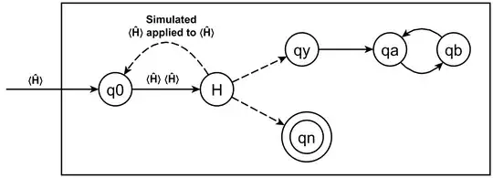

Refutation of the Peter Linz Halting Problem proof
The following shows how Linz H ⟨Ĥ⟩ ⟨Ĥ⟩ gets the right answer because Linz Ĥ.H ⟨Ĥ⟩ ⟨Ĥ⟩ gets the wrong answer
H ⟨Ĥ⟩ ⟨Ĥ⟩ ⊢* H.qy // Ĥ applied to ⟨Ĥ⟩ halts
H ⟨Ĥ⟩ ⟨Ĥ⟩ ⊢* H.qn // Ĥ applied to ⟨Ĥ⟩ does not halt
Criterion Measure
H is assumed to be a simulating termination analyzer that aborts the simulation of any input that would cause its own non-termination and returns NO. Otherwise H always returns YES.
Ĥ.q0 ⟨Ĥ⟩ ⊢* Ĥ.Hq0 ⟨Ĥ⟩ ⟨Ĥ⟩ ⊢* Ĥ.Hqy ∞ // Ĥ applied to ⟨Ĥ⟩ halts
Ĥ.q0 ⟨Ĥ⟩ ⊢* Ĥ.Hq0 ⟨Ĥ⟩ ⟨Ĥ⟩ ⊢* Ĥ.Hqn // Ĥ applied to ⟨Ĥ⟩ does not halt
Execution trace of Ĥ applied to ⟨Ĥ⟩
(a) Ĥ.q0 The input ⟨Ĥ⟩ is copied then transitions to Ĥ.H
(b) Ĥ.H applied ⟨Ĥ⟩ ⟨Ĥ⟩ (input and copy) simulates ⟨Ĥ⟩ applied to ⟨Ĥ⟩
(c) which begins at its own simulated ⟨Ĥ.q0⟩ to repeat the process
Same execution trace even when infinite loop is removed
It is true that Ĥ.H ⟨Ĥ⟩ ⟨Ĥ⟩ must transition to Ĥ.Hqn to prevent its own infinite execution. It is true that this makes Ĥ ⟨Ĥ⟩ halt. This entails that H ⟨Ĥ⟩ ⟨Ĥ⟩ would be correct to transition to H.qy.
When Ĥ.H ⟨Ĥ⟩ ⟨Ĥ⟩ and H ⟨Ĥ⟩ ⟨Ĥ⟩ correctly apply the above criteria then Ĥ.H ⟨Ĥ⟩ ⟨Ĥ⟩ would transition to Ĥ.Hqn and H ⟨Ĥ⟩ ⟨Ĥ⟩ would transition to H.qy
No one has refuted any of the above reasoning
polcott
  • 99
  • 14
