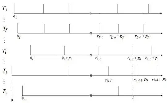

I try to prove the contrapositive just as Theorem 6.1 on page 124-126. So what I try to prove is that if according to an EDF schedule, the system fails to meet some deadlines, then its density is larger than $1$.
Suppose that the system begins to execute at time $0$. And at time $t$, the job $J_{i,c}$ of task $T_i$ misses its deadline. Assume the case that the current period of every task begins at or after $r_{i,c}$, the release time of the job that misses its deadline. We use $t$ to divide two types of task besides task $T_i$ as in below figure: 1) tasks with deadline happens before $t$ in the current period just like $T_f$, 2) tasks with deadline happens after $t$ in the current period just like $T_k$.
$J_{i,c}$ misses its deadline at $t$ tells us that any current job whose deadline is after $t$ is not given any processor time to execute before $t$ and that the total processor time required to complete $J_{i,c}$ and all the jobs with deadlines at or before $t$ exceeds the total available time $t$. So we have
$t<\left\lceil\frac{\left(t-\emptyset_i\right)}{p_i}\right\rceil e_i+\sum_{k\neq i,k\neq f}{\left\lfloor\frac{\left(t-\emptyset_k\right)}{p_k}\right\rfloor e}_k+\sum_{f\neq i,f\neq k}{\left\lceil\frac{\left(t-\emptyset_f\right)}{p_f}\right\rceil e}_f$
then
$t<\left\lfloor\frac{\left(t-\emptyset_i\right)}{p_i}\right\rfloor e_i+e_i+\sum_{k\neq i,k\neq f}{\left\lfloor\frac{\left(t-\emptyset_k\right)}{p_k}\right\rfloor e}_k+\sum_{f\neq i,f\neq k}{{\left\lfloor\frac{\left(t-\emptyset_f\right)}{p_f}\right\rfloor e}_f+\sum_{f\neq i,f\neq k}\ e_f}$
And it is
$=\left\lfloor\frac{\left(t-\emptyset_i\right)}{p_i}\right\rfloor e_i+\sum_{k\neq i,k\neq f}{\left\lfloor\frac{\left(t-\emptyset_k\right)}{p_k}\right\rfloor e}_k+\sum_{f\neq i,f\neq k}{{\left\lfloor\frac{\left(t-\emptyset_f\right)}{p_f}\right\rfloor e}_f+\sum_{f\neq k}\ e_f}$
$\le \left(\frac{t}{p_i}\right)e_i+\sum_{k\neq i,k\neq f}{\left(\frac{t}{p_k}\right)e}_k+\sum_{f\neq i,f\neq k}{{\left(\frac{t}{p_f}\right)e}_f+\sum_{f\neq k}\ e_f}$
$=t\sum_{h=1}^{n}\frac{e_h}{p_h}+\sum_{f\neq k}\ e_f$
$\le t\sum_{h=1}^{n}\frac{e_h}{\min{\left(D_h,p_h\right)}}+\sum_{f\neq k}\ e_f$
$=t∆+\sum_{f\neq k}\ e_f$
So I prove up to $t<t∆+\sum_{f\neq k}\ e_f$
but I cannot prove $∆>1$

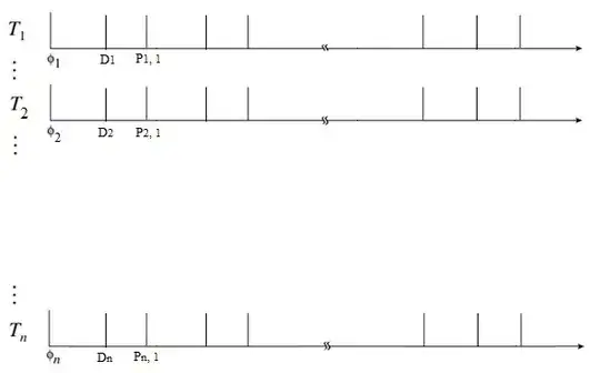

I might be too focus on the algebra. I believe I only need to argue or proof a scenario that would give the least density of the system that will fail to meet a deadline. As shown in the figure below, all tasks start at the same time with same period and deadline. For each of period, each task only have time slot D=D1=D2=...=Dn to execute. In other words, they share exactly the same time slot to execute. If density > 1 then obviously schedule will fail. If the below system has a density of $1^+$(greater than 1 by the smallest amount), then any changes on Di or Pi will only increase the density of the system or make the system feasible.
