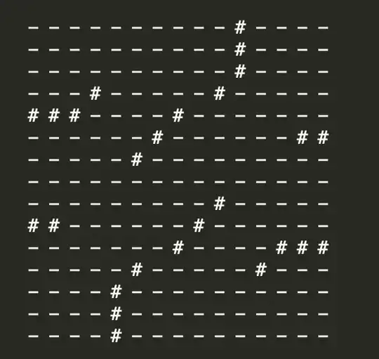

but as soon as I introduce a grid with the same dimensions but longer words with a larger number of intersections:
this algorithm becomes totally useless. It will never move past filling the 5-6 initially most constrained words (typically the central longest words as you would expect). I've never let the algorithm run for more than 59 minutes but it's never been able to find a solution (or even come close) to an open style grid like the one above.

Update: by increasing the amount of pre-processing at each successive step I am able to solve the above grid. In step 1 when calculating the most constrained word I find all possible candidate words for each remaining unfilled word, and map the possible candidates word's letter to each cell and do an intersection at each cell. This is beneficial because it better indicates the most constrained word and additionally eliminates more possible solution paths. However, this pre-processing makes the backjumping essentially useless. Using my dictionary of ~290K words I am able to solve the above grid but have still not cracked the upper echelon of the most constrained grids.
