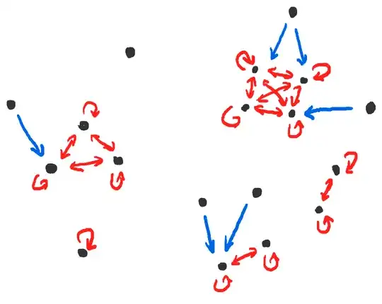

As a sidenote, the way to see Euclidean frames, is as a bunch of "clusters" of worlds, where a cluster is a group of worlds that are completely connected with each other (i.e. each world in the cluster can reach every other world in the cluster), with (optionally) some "outside" worlds that reach any number (including 0) of the worlds inside one (and only one) cluster, but are not reachable from any other world.
An example in a picture, with the "clusters" in dots connected with red arrows, and the "outside" worlds those dots with blue arrows leaving them:
Vsotvep
