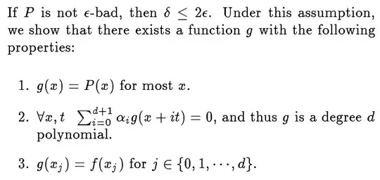

During the proof that the program Polynomial Self-Test has the desired properties, one introduces the function $g$ defined as $$\forall x\in F,\quad g(x)=\mathrm{maj}_{t\in F} \left\{\sum_{i=1}^{d+1}\alpha_i P(x+i\cdot t)\right\}$$ where the $\alpha_i$ are the field elements that satisfy, for any polynomial $Q$ of degree $\leq d$, $$Q(X)=\sum_{i=1}^{d+1}\alpha_i Q(X+i\cdot T)$$ These exist and can be defined in terms of the inverse of a Vandermonde matrix, and the paper even tells us they are binomial coefficients up to a sign.
The goal is nicely summed up by the authors: prove that under certain circumstances, the function $g$ thus ``defined'' is indeed the interpolating polynomial of the data, and mostly agrees with $P$: enter image description here
It is not clear to me how to interpret the definition of $g$. There are two definitions one could come up with:

The definition of $g$ should be interpreted in the following way:
Any function $g$ for which $g(x)$ is a majority value of $\sum_{i=1}^{d+1} \alpha_i P(x+i\cdot t)$ satisfies what follows.
Since it is later proved that $g = f$, it follows that $g(x)$ is always a strict majority (if it weren't, you would be able to define two different realizations of $g$, and prove that both of them are equal to $f$, contradicting their being different).
If you don't like this interpretation, you could fix a tie-breaking rule and use it to define $g$ conclusively. For example, you could take $g(x)$ to be the smallest majority value of $\sum_{i=1}^{d+1} \alpha_i P(x+i\cdot t)$. The exact tie-breaking rule makes no difference, since the proof shows that it is never actually used.
This kind of definition is common in the literature, and it is best to get used to it. Sometimes the authors explicitly mention that ties can be broken arbitrarily, but otherwise it is just implicitly assumed.
