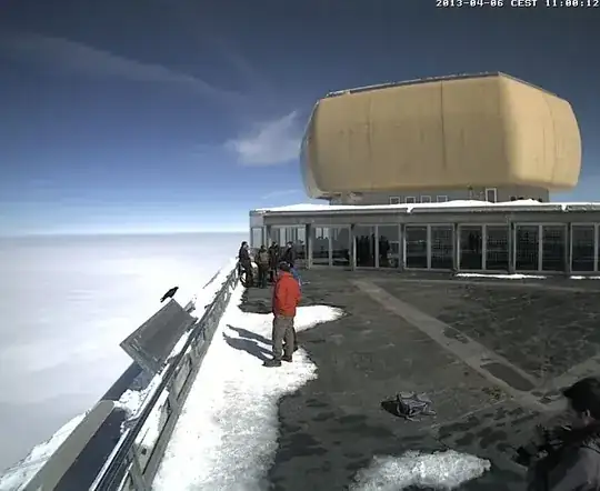

A sample from this webcam at a mountain top:
sunshine example
Clearly the sun is shining.

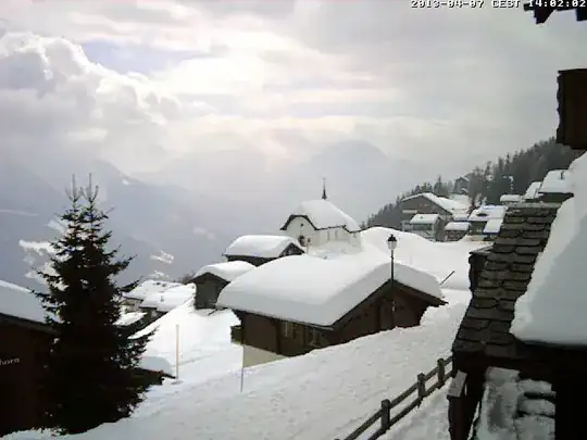

In this other sample it's far less obvious:
cloudy example
One could probably detect fairly easy whether it's foggy by trying to identify the tiny church spire on the chapel in the center. However, knowing very little about image processing I'd be surprised if there was a (combination of) algorithm that could reliably tell if there's sunshine or not.
