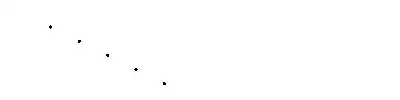

4,3,2,1,0

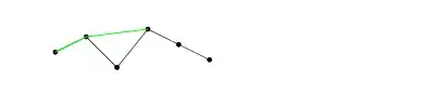

With two indices, we could find consecutive indices. With three indices, we might not be able to come up with $j=i+1$ and $k=j+1$. However, we can consider the case when there is a run of three strictly increasing elements ($A[i] < A[i+1] < A[i+2]$) to be solved, as it is easy to recognize such runs, and see how this condition might not be met. Suppose that the sequence has no strictly increasing run of length 3.

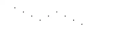

4,3,2,1,2,3,2,1,0

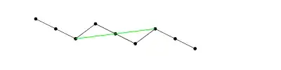

The sequence only has strictly increasing runs of length 2 (which I'll call ordered pairs for short), separated by a decreasing run of length at least 2. In order for a strictly increasing run $A[j] < A[j+1]$ to be part of an increasing 3-element sequence, there must be an earlier element $i$ such that $A[i] < A[j]$ or a later element $k$ such that $A[j+1] < A[k]$.

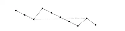

A case when neither $i$ nor $k$ exists is when each ordered pair is entirely lower than the next one. This isn't all: when the pairs are interlaced, we need to compare them more finely.

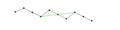

3,2,1,3.5,2.5,1.5,0.5,-0.5,1.25,-0.25 3,2,1,2.5,1.5,0.5,2,1,0
The leftmost element $i$ of an increasing subsequence needs to come early and be small. The next element $j$ needs to be larger, but as small as possible to be able to find a third larger element $k$. The first element $i$ is not always the smallest element in the sequence, and it is not always the first for which there is a subsequent larger element, either — sometimes there is a lower 2-element subsequence further on, and sometimes there is a better fit for the already-found minimum.
2.1,3,2,1,2.5,1.5,0.5,2,1,0 1,2,0,2.5,1.5,0.5
Going from left to right, we tentatively pick the smallest element as $i$. If we find a larger element further right, we pick this pair as a tentative $(i,j)$. If we find an even larger $k$, we've won. The key thing to note is that our pick of $i$ and our pick of $(i,j)$ are updated independently: if we have a candidate $(i,j)$ and we find $i' > j$ such that $A[i'] < A[i]$, $i'$ becomes the next candidate $i$ but $(i,j)$ remains. Only if we find $j'$ such that $A[j'] < A[j]$ will $(i',j')$ become the new candidate pair.
