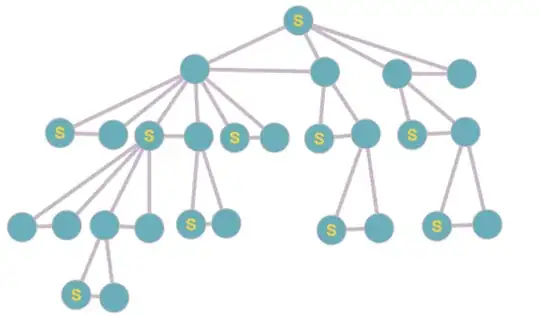

The graph below is a positive answer without words.
http://graphonline.ru/en/?graph=DklYKPXxGybFYZxz
Here is the detailed proof.
