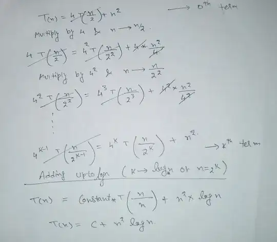

I always use following approach: Try to avoid master theorem as a recursion solution gives you more insight to the structure of the problem:
Recursion
That's a recurrence of the form: $T(n)=aT(n/b)+f(n)$. In your case $a=4$, $b=2$, and $f(n)=n^2$. This is case 2 of the master theorem. It follows that $T(n)=\Theta(n^2\log n)$.
