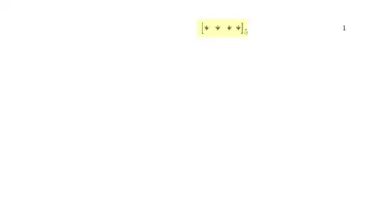

Executing B&B as specified above, this happens:
algorithm
This GIF does not loop. Reload it in a new tab to see from the beginning.
[source] [static version]
Note that out of 41 nodes, only four are visited properly and only for ten are lower bounds computed.
