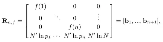

I decided to give it a go and I found myself utterly mystified by an early claim in the paper. He considers a permutation $f$ of $\{1,\dots,n\}$ and defines column vectors $b_1,\dots,b_n,b_{n+1}$ as below
where $p_1=2,p_2=3,\dots$ are the first $n$ primes and $N'$ is irrelevant to my issue (I presume). He considers a linear combination with integer coefficients $e_1,\dots,e_n$ of the first $n$ vectors
$${\bf b}=\sum_{i=1}^n e_i{\bf b}_i \in \mathcal{L}(R'_{n,f})$$
sets
$$u=\prod_{e_i>0} p_i^{e_i}, v=\prod_{e_i<0}p_i^{-e_i}\in {\mathbb{N}}$$
and writes
$$\hat{z}_{{\bf b}}=N'\ln{(u/v)}$$ for $b$'s last (i.e. $(n+1)$-th) coordinate.

The issue I have is with the estimate of a lower bound for $\|b\|^2$ that follows. Schnorr writes
This seems to be false on the face of it: it asserts that $$\sum_i e_i^2f(i)^2 \geq\sum_i |e_i|\ln(p_i)$$ But if the permutation $f$ is chosen so that, say, $f(n)=1$ then choosing $e_n=1$ and all other $e_i=0$ yields $$1\geq\ln(p_n)$$ which, unless I'm missing something, is patently false.
Furthermore, unless $e$ is the zero vector there is no way that the claimed inequality can ever be an equality since, upon removing the $\hat{z}_b^2$ term from both sides, the right hand side $\ln(uv)$ is irrational, being the natural log of an integer $uv\geq 2$, whereas the left hand side, $\sum_i e_i^2f(i)^2$, is a positive integer.
Am I missing something? Can someone guess the correct statement he is trying to prove?
