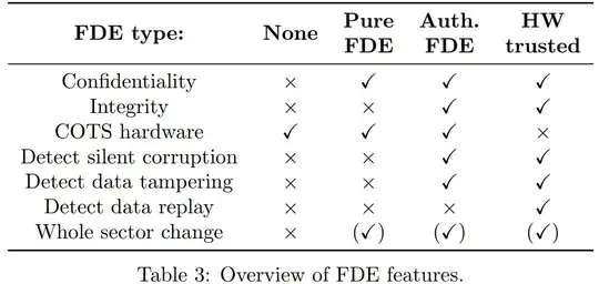

Overview of FDE Features
"Authenticated encryption enforces that a user cannot read tampered data but will see an authentication error. It not only stops any attempts to use tampered data on higher layers, but also helps a user to realize that the device is no longer trustworthy. An overview of the features among FDE types is summarized in Table 3.".

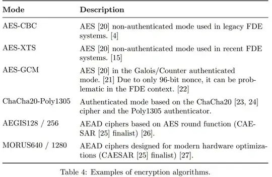

Table 4: Examples of Encryption Algorithms
The encryption operation output consists of the encrypted data and the authentication tag. Authentication mode with additional data (AEAD) calculates the authentication tag not only from the input data but also from additional metadata, called additional authentication data (AAD). Table 4 summarizes examples of the encryption modes mentioned in this text.".
