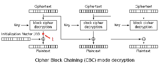

To see how this is done, refer to the diagram below (copied from https://en.wikipedia.org/wiki/Block_cipher_mode_of_operation):
Consider point labeled E. E is the AES decryption of the first block (in the case, the only block) of ciphertext, using the key. We don't know the key, so we can't compute E...
Or, can we? Looking further, the first block of ciphertext is E XOR IV. The XOR function is unique in that: if A XOR B = C, then you can re-arrange A, B, and C in any order, and the expression still holds true - i.e. A XOR C = B, and B XOR C = A. So:
Plaintext = E XOR IV
E = Plaintext XOR IV
IV = E XOR Plaintext
