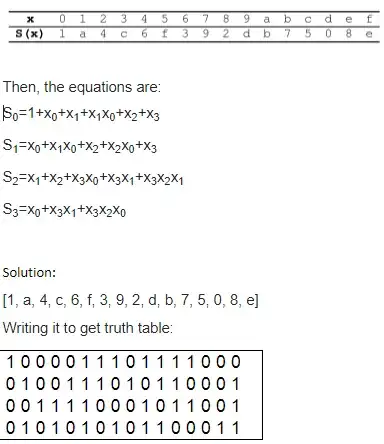

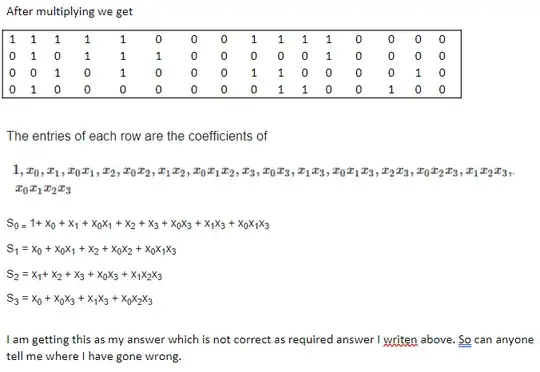

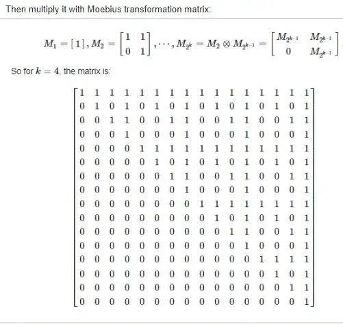

I tried to solve SBox as given in this link
I am trying to understand this paper SBox. In this on page no.4 the correct equation of given SBox is mentioned. I am not getting how to design ANF equation as given in paper.

The blow the result of the article
\begin{align} s_0 &= 1 + a + b + ba + c + d \\ s_1 &= a + ba + c + ca + d\\ s_2 &= b + c + da + db + dcb\\ s_3 &= a + bd + dca\\ \end{align}
