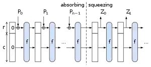

I find that the following image from Wikipedia, though perhaps a bit too technical for your purposes, is still helpful with a little explanation:
Sponge function diagram
Essentially, a function $f$ is used repeatedly in two phases, absorbing and squeezing.
In the absorbing phase, small chunks of the input data are mixed into the beginning of the buffer using XORs (using the variables from the image: $r \oplus P_i$). This updated buffer value is then passed through $f$ and the process continues. With each step a small amount of input data ($r$ bits) is "absorbed" into the buffer using $f$ to semi-randomize the entire buffer.
In the squeezing phase, the same process is repeated but instead of XOR-ing the first $r$ bits with data, they are extracted as the next $r$ bits of the output.
tl;dr: The input is mixed into a buffer in small chucks in between phases where the buffer is randomized, then the buffer is randomized repeatedly while small chucks of it are taken as output.
For more detailed information, see this web page and this paper by the Keccak team.
