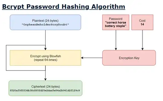

bcrypt cannot do that. Bcrypt always and only ever generates 24 bytes. Which means it cannot derive a 256-bit key.
The internal implementation detail of bcrypt is that it encrypts the text:
OrpheanBeholderScryDoubt (24 characters)
and encrypts it 64 times.
ecIaryFCJAyINKZZnhFGvSRB (24 bytes)
The resulting 24 bytes is then returned to you in a special serialized string form (along with other stuff):
$2a$10$Ro0CUfOqk6cXEKf3dyaM7OhSCvnwM9s4wIX9JeLapehKK5YdLxKcm
\___________________________/\_____________________________/
          other stuff             24-bytes of "strong" data
And while you can be clever enough and abuse bcrypt - ripping out the final 24-bytes of the base-64 encoded data:
hSCvnwM9s4wIX9JeLapehKK5YdLxKcm (24-bytes of base64 encoded data)
But you didn't derive a key.
  • Not only because nowhere was a parameter passed asking how many bytes you'd like to derive
  • but because it's only 192-bits
  • if you wanted to derive a 256-bit key
  • you're out of luck
  • because bcrypt is not a key-derivation function
It's a password hashing algorithm
