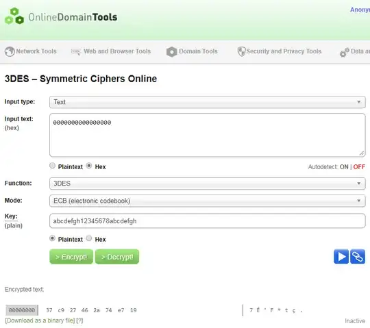

I've also tried using http://online-domain-tools.com/ for a reference, which gives the same result as the Python code.
online-domain-tools result
Can anyone offer any insights into why OpenSSL produces a different result?

In Python and on that website, you're entering a key. A 3-DES key consists of 24 bytes. You picked a key that's some nice printable text, but a key in general is binary, randomly generated.
With the OpenSSL command line, you're supplying a password (or passphrase, the two words are synonyms). A password is not a key: it's typically not fully random, consists only of printable characters, can have any length, ...
OpenSSL uses a key derivation mechanism to calculate a key from that password. To generate a key from a password, you need to perform stretching and randomize the process with a salt, which OpenSSL does, although not very well.
To get the same result with openssl en, tell it that you're supplying a key, with the -K option.
