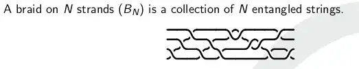

Have you ever heard of the Walnut Digital Signature algorithm? It's literally based on the math of tying knots in ropes. With some fiddling, you might be able to work it into a pub demo.
Presentation slides, white paper, esp. section 2.1. It's a candidate for NIST's post-quantum crypto competition, so it's not even a toy algorithm.
From the presentation slides:
Walnut DSA Braids
Imagine this is 4 strands of rope crossed either over or under another strand. Notice how some of those pairs of crossings will "pull straight" if you grab the ends and tug?
The intuition of the signature algorithm - as I understand it and simplified to the point of being wrong - is to encode the (hash of the) message to be signed as a sequence of crossings in a braid, then you apply the private key to add an extra pile of pseudo-random crossings to the braid. The public key is an "inverse" set of crossings such that when you apply the public key and "pull" you'll get back the original braid that encodes the (hash of the) message.
