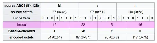

This is taken from the Wiki entry for Base64:
base64 example
If you really intended to tamper Base64 encoding to provide encryption, it could be done at the Index level highlighted above. You would need a secret key, a key derivation function tailored to create a high entropy seed which then started off a pseudo random number generator. The generator's (6 bit) output would then be XORed with the Index to change the encoding for every character. And this technique can be reversed to decipher the encrypted message.
You see that it's all a bit of a bother. Traditionally you'd create the cipher text and then encode it. Other than cropping a typical 8 bit random sequence to 6 bits, the workload is identical though to the traditional stream cipher. Actually you need 33% extra computations, but that's neither here nor there.
You might be the first to have thought of this Base64 variant as no one seems to be aware of similar behaviour. This should work though.
