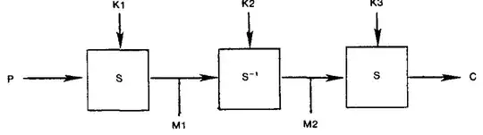

Here is the answer to this question. There is an attack based on the following paper: http://cs.jhu.edu/~sdoshi/crypto/papers/p465-merkle.pdf
Here is a visualization on what happens: Visualization

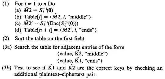

Here is the algorithm:
Algorithm to attack
Two things happen in step 1 (a). The decrypted value of 0 is interpreted once a M2 with the key $k_{2}$ and once as $P_{0}$ for the key $k_{1}$. This means with just one operation we get 2 values!
In step 1 (b) the value gets saved in a table with $i$ which represents the key $k_2$, and a label middle. This table will be used for a table look up (TLU) later on.
In step 1 (c) you see there is an $ENC(S^{-1}_{i}(0))$ where $S^{-1}_{i}(0) = M2$ from step 1 (a). This is a CPA request. We ask the algorithm to encrypt the value from the first step. This goes into another decryption $S^{-1}_{i}$, where $i$ represents $k_{1}$.
The value from the previous step is saved in the table with $i$ ($i$ = $k_{1}$) and a label ends.
The last steps should be self explanatory.
The question is: Why is it working? Let's have a look at step 1 (c) again:
$S^{-1}_{i}(Enc(S^{-1}_i(0))) = S^{-1}_{i}(S_{k1}(S^{-1}_{k2}(S_{k1}(S^{-1}_i(0)))))$
You see, that if $i = k1$ we get the following:
$S^{-1}_{i}(Enc(S^{-1}_i(0))) = S^{-1}_{k2}(0)$
This is saved in the table and that is the reason why we look for adjacent entries in the table with the labels.
Complexity:
  1. The for loop goes from 1 to n: $O(2^n)$
  2. Within the loop we have $2^n$ CPA requests
  3. Space: When I am not mistaken: $O(2^{2n})$
I hope it helps some people :)

As far as I know your attack is the best attack known, unless something better has very recently been published.
Please note that for DES as the basic cipher the chosen $A$ may not work, but you can choose another $A$ and try again
Also, for a generic cipher with $k$ bit key, the complexity is $$2^{k+1}=2\times 2^k=O(2^k),$$ as $k$ increases.
