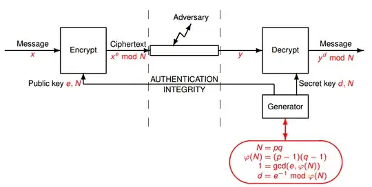

For completeness I show you the model of RSA I'm working on (the very basic one)enter image description here

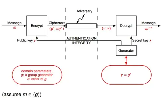

and also the ElGamal model I'm working on: enter image description here
In fact ElGamal advantages are also pointed out. First generation of parameters is more efficient and second ElGammal works in various types of groups while the setup for RSA is $\mathbb{Z}_{n}$. So the comparison should be done over $\mathbb{Z}_{n}$.

What the notes remark is that the ciphertext in ElGamal encryption in $\mathbb Z_p^*$ is about twice as large as the ciphertext in RSA, when working with $p$ and $N$ of about equal size; that's because the ciphertext $(u,v)$ in ElGamal has 2 integers, when $y$ in RSA has 1; and $u$, $v$, $y$ are about the same size (also the size of $p$ and $N$). Making $p$ and $N$ of about same size makes sense, because that give comparable security (for proper other choices).
Larger ciphertext is bad in some sense, because that makes ciphertext transmission even so slightly longer, and requiring extra resources. That fact is not very relevant in practice:
  • A factor of 2 in size there maters in only some applications (and almost not on anything where the message goes thru a modern network), because practice does not use either ElGamal or RSA for bulk data encryption; its uses hybrid encryption, in which the bandwidth used for asymmetric encryption is small in absolute value, and most often in proportion.
  • ElGamal encryption can be done in groups (like, elliptic curve groups) with much more compact representations of elements, and then the balance of ciphertext size shifts straight in the other direction, with ElGamal the winner by a factor of more than 2; so in the rares cases where ciphertext size matters, we want to use this ElGamal variant.
