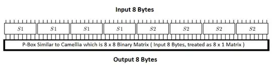

Variation-1
  1. $64$ bit input is divided into $8$ bytes
  2. Byte $0,1,2,3$ are substituted with Sbox1
  3. Byte $4,5,6,7$ are substituted with Sbox2.
  4. Then a $8 \times 8$ Binary Matrix is applied on the 8 bytes from 8 rows (Matrix similar to Camellia).

This is your 1st variation. enter image description here

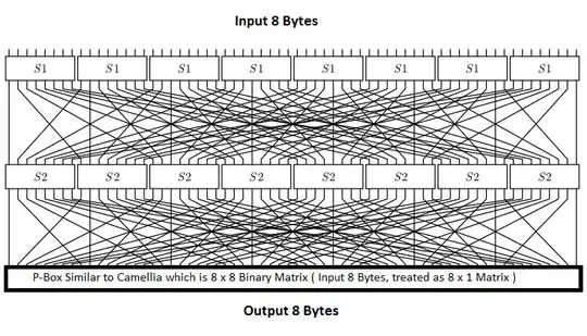

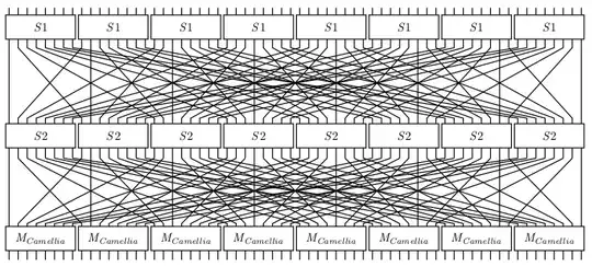

This is your 2nd variation (your $8 \times 8$ matrix idea is equivalent to apply a permutation). enter image description here
In your first variation, the application of the matrix is useless, one can consider the $S1$ (or $S2$) and the matrix as a single S-box. Hence you have no security gain.
In the second variation, you can see that even if you find the right differential on $S1$, it became harder to exploit because you apply a permutation before the following $S2$ (and subsequently the application of the matrix which is equivalent to another S-box).
Remark: Because in the second scheme you use a permutation, they cannot really be compared (apple vs oranges...)
With this in mind, I will let you decide which of these two variations is the most secure...
