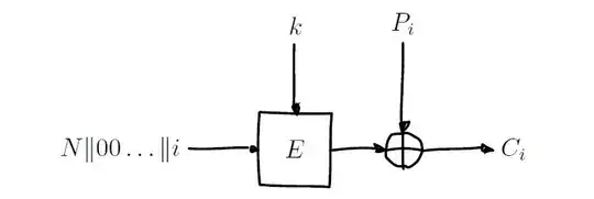

I, as they say, "rolled my own cryptosystem". It is a C# CTR encryption method, that is modified. Based off of this diagram:
CTR mode
I hate the idea of padding, so instead of padding, it just encrypts the remainder of the plaintext with a separate key called rpass. Please do not bash me for doing so. As I said, this is a homemade algorithm.

This stream-cipher algorithm can be summarized like this:
$C_i = P_i \oplus K_j \oplus \frac{i}{|K|}$ with $j = i \, (mod \, |K|)$
Essentially, the key is repeated up to the length of the plaintext. The number of key repetitions is also added to the key, then the key-stream is added to the plaintext to produce the ciphertext byte. When $|K|$ does not divide $|P|$, then a second key is used to encrypt trailing bytes of plaintext.
One problem that I feel confident in pointing out, is that this is vulnerable to a chosen-plaintext attack. If the attacker is allowed to choose $P$ and sets:
$P_i = \frac{i}{n}$
he can learn that the key is just the first $n$ bytes of $C$ by guessing $n$ and checking that
$C_i = C_j$ with $j = i \, (mod \, n)$
which is satisfied when he guesses correctly.
Under this attack model, assuming a key-length of up to 512 bytes, the algorithm provides 9 bits of security.
