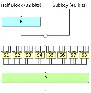

The placement of the p_box in the Feistel function is shown here: enter image description here

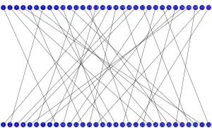

The permutation itself is shown here:

Note: you should also take into consideration the Expansion table, as it glues together with the Pbox.
The simplest thing you would like to want from a Pbox is to provide a good diffusion on the inter-sbox level. That is, a single sbox should have an effect on many sboxes in the next round. This is not sufficient, for example you could have some indepent groups of sboxes. So you need to see how many rounds are needed to prodive full diffusion, for each of the sboxes.
For example, PBoxes which make some independent groups of sboes, do not provide full diffusion at all and are considered unsecure. Also, consider Pbox which matches sboxes like $(2, 3, 4, 5, 6, 7, 1)$ (e.g. 1 shift left). You need at least 7 rounds to provide full diffusion.
For DES I think 2 rounds are enough for full diffusion, so that is at least acceptable.
Of course I described the very basic property of the PBoxes, which is not sufficient to say that a PBox is secure for a cipher. For another example, you can consider weak sboxes, for example if 2 sboxes are weak. Some PBoxes may resist it, some PBoxes may make the cipher much more weaker.
