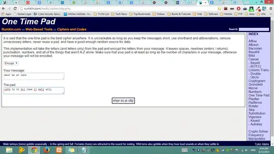

I was playing with the Vernam cipher on some online converter.
But when I tried to encrypt my message string with numbers, it remained unchanged.
Moreover, it was ignoring numbers and was encrypting as some alphabet appears in the key.
So, can we use numbers as a pad in the Vernam cipher - why or why not?

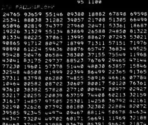

Here is one example of what a CIA one-time-pad key looked like during the Cold War:
OTP numbers example

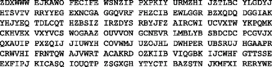

When it comes to the Vernam cipher the answer is "you should, but for some reason you can't". That reason is most likely the fact that, although Morse code does encode digits, they don't appear to be used with the cipher, as this picture from Wikipedia shows
ciphertext

But that is still conjecture on my part because the author of the tool you tried to use has to say the following:
// One-Time Pad
// This code was written by Tyler Akins and placed in the public domain.
// It would be nice if you left this header intact.  http://rumkin.com
// Implements a one-time pad for only alphabetic characters.  Preserves
// the character case in the text (not the key).
// encdec = -1 for decode, 1 for encode
// text = the text to encode or decode.
// key = the key (pad) to use
