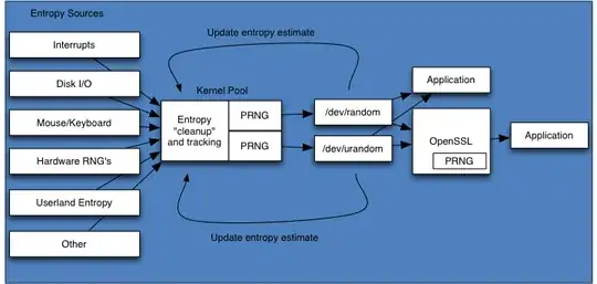

There are many great sources of true randomness. But any one of them may fail, or otherwise be insufficient due to speed of generation, quality or unavailability (malicious or incidental). The standard(4) is to use collections of TRNGs together to minimize the chance of catastrophic failure.
Fig. 1 | Illustration of a typical entropy life-cycle management system.
It's generally accepted that the faster, more uniformly distributed, more entropic and more efficient, the better. But the point of using PRNGs and TRNGs together, perhaps to create a CSPRNG, is that: Once enough initial randomness has been acquired, speed, uniformity and entropy can be gained by continuously seeding the pools with even rather low-quality TRNGs, and then extracting outputs using an efficient PRNG, such as a light-weight symmetric cipher or hash function.
