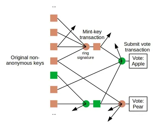

Linkable ring signatures
Another option that gets rid of the authority would be linkable ring signatures. This is the same thing used in CryptoNote based currencies.
Back’s Linkable Spontaneous Anonymous Group (bLSAG) signatures
Users cast a vote by creating a ring signature from one of N keys, their key, and N-1 decoys. There's some extra magic that prevents a key from being used twice by having a "linking value" in the transaction that depends on the actual key used for signing.
Users get a token that allows them to publish a key to the list of allowed keys. A ring signature using keys from the allowed set allows for submitting a transaction. Transactions either add a new key to the set of allowed keys or submit a survey response.
Each resulting vote can be seen as a tree of possible inputs with each transaction being a node that leads to other nodes eventually bottoming out to the original keys tied to the tokens sent via Email.
The green nodes are the keys, ring signature and votes submitted by one user. Notice how they link their vote to multiple transactions and through those transactions to many of the original non-anonymous keys. This creates a directed acyclic graph of links between votes and the original email linked keys.
The authority must not know the secret key corresponding to the non-anonymous keys. If they do, they know the the linking value used to prevent double spending and can link it to the transaction that spends it. No anonymity is provided by using it as a decoy. The Authority can use the voter's published public key or the voter must use that initial key to mint another (with a simple non-ring signature) before using it later.
Someone needs to run the ledger but they don't need to be trusted except not to delete transactions outright from it. Either have the ledger operator sign receipts for collected transactions or do a distributed ledger as in traditional blockchains.
performance and anonymity
The only reason to use this method is to have the results be verifiable.
The anonymity provided is less than that provided by blind signatures and performance, code size, everything else is worse. Good anonymity requires either monstrously sized ring signatures or that users submit multiple key minting transactions that form a well connected tangle. Participants that collude can reveal where each node actually goes removing it from the graph of honest transactions and reducing anonymity for non-honest users.
Recent work "Omniring: Scaling Private Payments Without Trusted Setup" makes this scale a lot farther since they get ring signature size and verification time down to something logarithmic in ring size. Ring signature generation time is still linear but that's a per-user cost.
