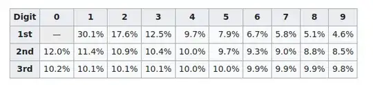

Actually, bank and expenses fraud is identified for the very opposite reason.
Many of human societal numbers begin with a small digit, with number 1 appearing as the leading significant digit about 30% of the time. It would occur approximately one third as frequently in a random situation (11.1%).
This phenomenon is called Benford's law and produces the following distribution for the first three digits of many human made numbers:-
So I guess that in the generalized case, humans are poor at not just generating uniformly distributed random numbers, but poor at generating any specific distribution.
I haven't done this, but it would be interesting to manually generate a sequence according to a Normal distribution and then test it for normality.

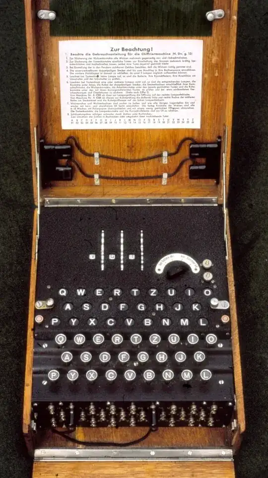

Since you mentioned you're also interested in crypto examples, here's one from probably the most famous cipher machine in history: Enigma.
Most of Enigma's key settings were distributed in a keysheet and changed daily but there was also a per-message key that had to be randomly chosen by the operator, corresponding to the initial rotor positions: Enigma machine (three white squares in the middle of this picture, you can just about make out the settings VGT - these actual positions changed after every letter but that's not relevant here)
To transmit these the sender must create six random letters and send the first three (Grundstellung) in plain, then the next three (Spruchschlüssel) encrypted using the settings of the Grundstellung. The Spruchschlüssel would become the actual initial settings and wasn't particularly useful without the daily key settings but could be used as a first step in cracking. It was therefore very important that it was not predictable (like AAA or your initials), not related to the Grundstellung (the same or two halfs of a 6 letter word) and neither part was reused between messages.
Obviously all three of these things happened a lot and while it wasn't the biggest flaw in the system it certainly helped cracking some messages faster.
More details: https://www.bbvaopenmind.com/en/technology/innovation/the-human-errors-that-defeated-enigma/
