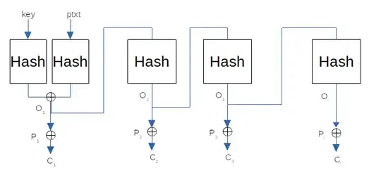

There is no such weakness if SHA-256 is used in CTR mode. ChaCha20 is already one built in this way.
You are using SHA-256 in a chaining way to output a stream to encrypt the message with x-or;
\begin{align} O_1 & = H(key) \oplus H(message)\\ O_i & = H(O_{i-1}) \end{align}
Then the encryption is executed with x-oring $O_i$s.
$$C_i = P_i \oplus O_i$$
Now assume that you have a known-plaintext for some block $j$. This means that you get $O_j$
$$O_j = P_j \oplus C_j$$
Now use the stream producing equation
\begin{align} O_{j+1} &= H(O_j)\\ O_{j+2} &= H(O_{j+1})\\ \vdots \quad & \quad\quad\vdots \\ O_{j+t} &= H(O_{j+t-1})\\ \vdots \quad & \quad\quad\vdots \\ \end{align}
As you can see, you get the rest of the stream output from the position $j$. If you have the first position then you will get all.
This is the weakness of such a scheme on the other hand the CTR mode is designed for PRFs and it is common to initialize it with some good hash functions.
See with an image
As one can see, if you get any of the output $O_j$ then you can get the rest due to the hash chaining.
