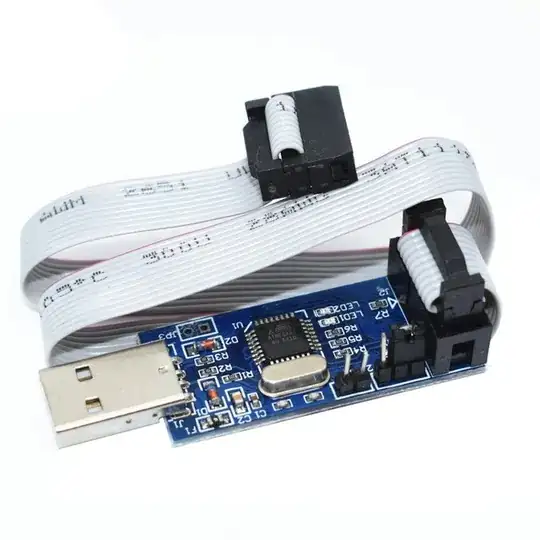

Options 2 and 3 is where you would require an In-circuit Serial Programmer (ISP). Such as a USBasp: USBasp - USB programmer for Atmel AVR controllers
USBasp
or you can use another Arduino, see Arduino as ISP and Arduino Bootloaders.
An ISP device basically converts the USB to TTL signals (along with a serial protocol (JTAG or derivative)) which then connects to the ICSP2 interface on the controller board:

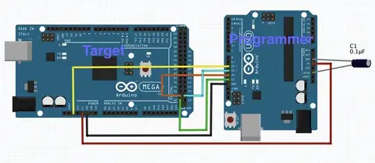

To program the Mega2560 using an Uno, connect as follows:
Uno as ISP programming Mega

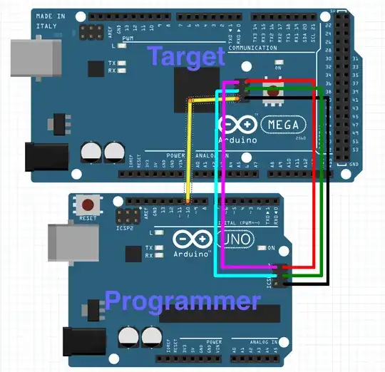

or using the ISP connector (in this diagram the electrolytic capacitor3 is not shown):
Uno as ISP programming Mega via ICSP connector
Take note of the electrolytic capacitor3 on the programming device:
The 10 µF electrolytic capacitor connected to RESET and GND of the programming board is needed only for the boards that have an interface between the microcontroller and the computer's USB, like Mega, Uno, Mini, Nano. Boards like Leonardo, Esplora and Micro, with the USB directly managed by the microcontroller, don't need the capacitor.

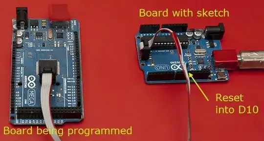

or using the Mega's ICSP connector, from Atmega bootloader programmer (see original image):
Uno programming a Mega
Note D10 is used, not RESET4

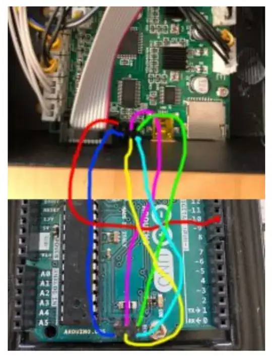

or, like this, from Chaos Drucker - CREALITY ENDER3 MIT MARLIN AUSSTATTEN (see original image):
There is an error in the image and the red line should go to D10 and not D9 as shown
Uno to controller board connections
Note, again, that the RESET on the Arduino Uno's ISP connector is not used (and Pin 10 is used to connect to the controller's ICSP's RESET pin instead)4.

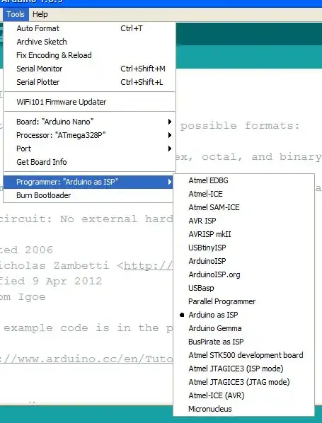

Then in the Arduino IDE you will need to select the Programmer to be used, in this case Uno as an ISP, like so:
Uno as an ISP
Once you have connected correctly, and selected the programmer, then you should be able to hit compile and upload as usual.
