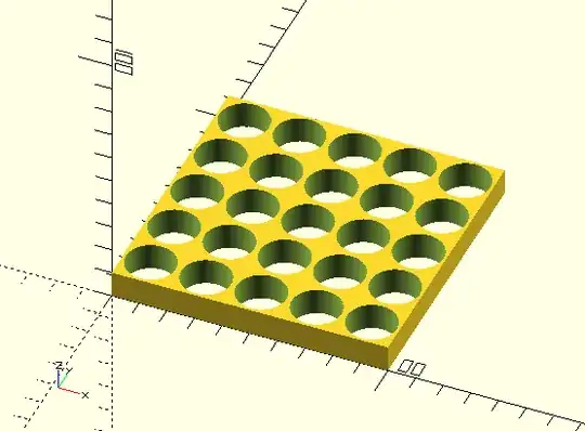

Small OpenSCAD test script:
 tol=0.2;
difference(){ cube([100,100,10]); for (x=[10:20:90]){ for (y=[10:20:90]){ translate([x,y,-tol/2]){ cylinder(r=9,h=10+tol,$fn=180); } } } }
This can be used for both parts of your question, but in case the pattern needs to be inside an object you need to lower the value of h in the subtracting cylinder and raise/translate it (you could use the center=true in the cylinder function as a parameter and raise the center to the middle of your object translate([x,y,objectThickness/2])). You could make a module of the recurring pattern yourself to create your library.
note: Replace cylinder with cube or any other geometrical solid or (2D) pattern (use linear_extrude) to subtract from your part.
