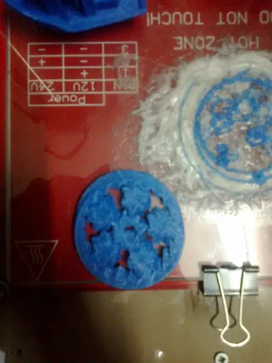

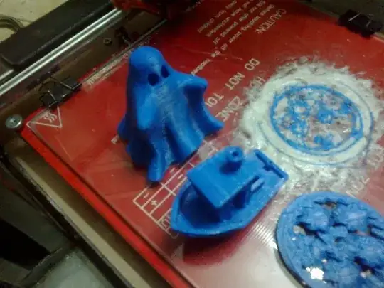

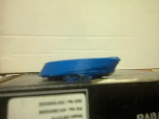

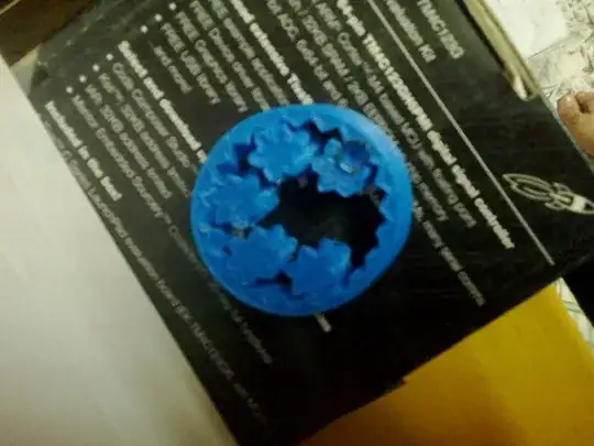

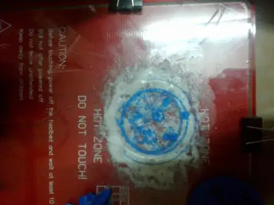

I have made a custom 3D printer with RAMPS electronics. I have printed a Benchy (ship) well, but when I try to print anything with teeth (spiral vase), gears (bearing), or a circle (rocket), the Y-axis skip steps in a regular rate giving 70-60 degrees skew along the printing the Y-direction, but each layer is perfect, this happen when printing gear bearing.
  • I have checked Y-axis ball bearing, motor, tension belt and I have replaced my 6 mm glass with 1 mm without any difference in shift.
  • I have once make it work, but I don't why or how (I have lowered speed to 50 and did some random things).
  • I have printed from Pronterface and when I pause it, then home Y, the skipping in Y is corrected.
  • If I drive my X/Y-axis with no microstepping, then the skipping is much larger.
  • I only use Slic3r for G-code generation.
with no micro stepping
with 32 micro stepping
with 32 micro stepping with 32 micro stepping with 32 micro stepping question:
  • What is the cause for that skipping?
  • If there is more than one possibility, how could I check them separately?
  • I have changed my Y-axis motor with no change.
  • I have swapped X&Y connections with no change - still Y skips.
  • I have lowered jerk and max. speed and it prints gear bearing well and it is spinning, but when I tried to print spiral vase Y motor skipped.
