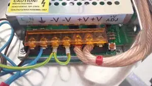

It sounds a bit like you are having (additional) grounding issues1. Are your MacBook and the RAMPS using the same ground, i.e. are they using the same mains circuit?
If you are using the same power strip, then the next thing to check would be that the PSU on the printer correctly grounded (at the bottom of the unit).
From David Crocker's superlative blog, see Upgrading the large delta printer - Power supply output grounding:
While taking some measurements on my machine, I discovered that the negative side of the output of the 12V LED power supply I am using was not connected to ground inside the power supply as I expected. This presents a safety hazard. So I added an additional wire from ground to the spare negative output terminal of the power supply.
Correctly grounded power supply
