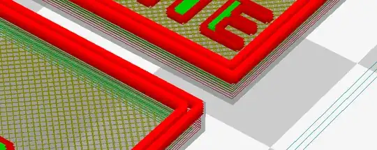

I've just tried to make some small labels with embossed lettering. Base is 1.5 mm, with letters and a perimeter protruding by another 1 mm. After printing, I realised that Cura is not giving me a top layer, all I get is an inner and outer wall for the perimeter and the lettering:
Screenshot showing missing infill in top layer
The base is OK, with 4 layers, but there is no infill at the top. Presumably there is a setting that I've missed (I can appreciate that maybe this is a detail to the slicing which is model dependant). Layers are 0.2 mm, top and bottom set to 4 layers.
I had walls set to 1.6 mm, (4 layers) and the wall features here are 1 mm (i.e. 2.5x the nozzle). The features are solid so far as I know, not drawn as a hollow.

What is your source model? Typically this "missing layer" effect happens if the source has a wall thickness less than the size of the extruder nozzle selected. Cura will view that part of the model as non-printable.
Meshmixer and TinkerCad (among many others) will allow you to set and change thicknesses in the model.

What is happening here is that Cura is struggling with the quantised extrusion width. This behaviour can be improved in the slicer, they have a issue tracked here https://github.com/Ultimaker/Cura/issues/1303 and 2.4 beta has improved it.
There are some pictures in this answer which show how Cura 2.3 slices a rectangle of increasing width. I got nothing at the nozzle width, then a pair of overlapping lines up to twice the width (which I assume will be over-extruded due to the overlap). For anything wider than simply two sides, the result depends on the number of walls requested.
  • One wall results in 100% infill for small regions (regardless of the infill setting). This is good, but maybe 1 wall is not apropriate for the whole model.
  • Multiple walls seem to prevent the infill untill there is space for pairs of walls. So width of 3x nozzle has a gap. Small tweeks to the nozzle size can maybe push this quantisation point about, if 1 wall is not a good workaround.
For rectangular geometry, it's worth trying to quantize small parts in 0.8mm increments. For curves, setting 1 wall shell might be better.

Try Cura 2.4.0-beta2: there is option named "Fill Gaps Between Walls" under "Shell" settings, set it to "everywhere". In stable Cura 2.3.1 this option is missing.
