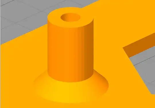

The screw hole mounts seem well-designed to me:
3D print preview

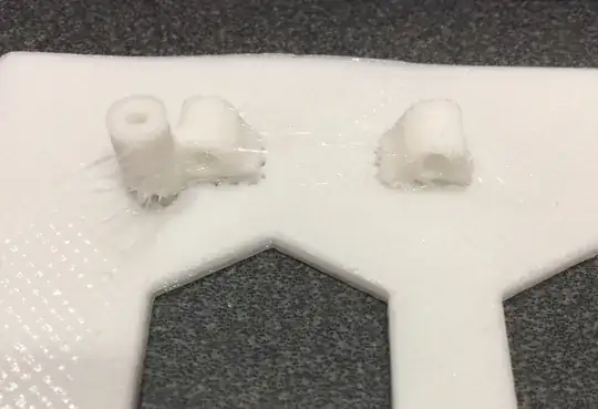

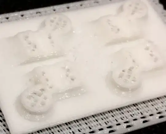

No 90 degree transitions - I would think this would be the least of my problems. But last night they had serious problems:
Example 1
Example 2
I haven't seen a problem like that before. Extrusion rate seems basically perfect - why does it look like it just stopped extruding around the perimeters?

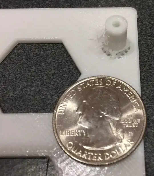

UPDATE: Increasing outline overlap from 60% to 90% almost fixes the problem (at least visually if not structurally) - there's just one small hole at the base of each structure. (I stopped the print a few layers after the problem layers do ignore the tops.)
Updated Image
Going to 99% (Simplify3D's max) would probably get rid of those last holes but I have to think that maxing out S3D's outline overlap setting to just barely make the print work means I haven't found or addressed the true root cause...

Since you said you don't have a cooling fan, try lowering the temperature on your print head to something like 205. The strings in the first and second picture also occur more often when the print temperature is too high as well.
The layer time gets really small at that transition, so make sure the print speed is slowing down while printing that part of the object and pausing in between those layers to allow for cooling.
It looks like the plastic is still molten and is being dragged around too me.

It looks like the first layers that are making the vertical transition do not have enough to stick to and are curling up. Are you using a cooling fan?
