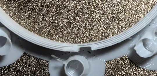

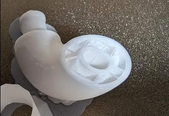

From the underside, the bottom layer is nicely merged

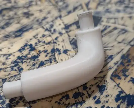

The result looks fine externally, but the gap between the walls looks huge (relatively speaking)

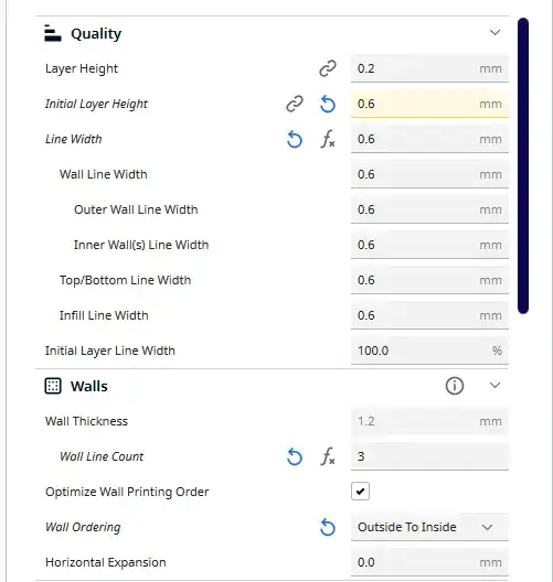

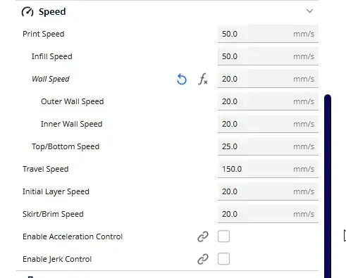

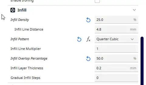

Here are my slicer settings. I increased the line width, infill overlap percentage, and wall line width. I slowed down the wall speed. and I get the same result. From what I've read, this is under-extrusion but I don't know what else to try.
