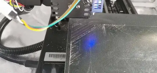

Whenever I try to print it starts well, then after printing a few strokes, the print systematically fails. It is not an adhesion/levelling problem as I installed a BLTouch probe and made a 12x12 points grid of my 200x200 printing bed, which works perfectly with PLA. It seems that after printing a few lines, the nozzle just stopped extruding filament anymore (see photos); although the extrusion gear still seems to be turning.

Photo of a 3D model printed with TPE filament failing at the edge

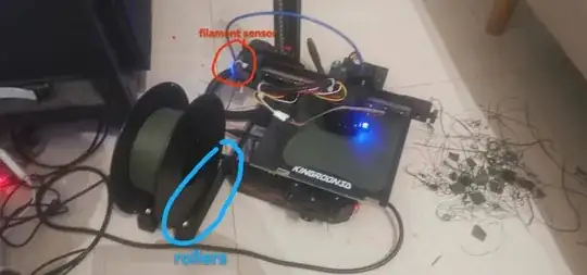

The out of the box setup of the KP3S pro is with the filament roll being set on rollers and passed into a filament sensor to anticipate situations where filament is running out.
Out of the box setup for Kingroon KP3S
However, this sensor applies pressure on the filament, and it creates a mechanical strain that prevents more elastic materials from being pushed through the extruder.

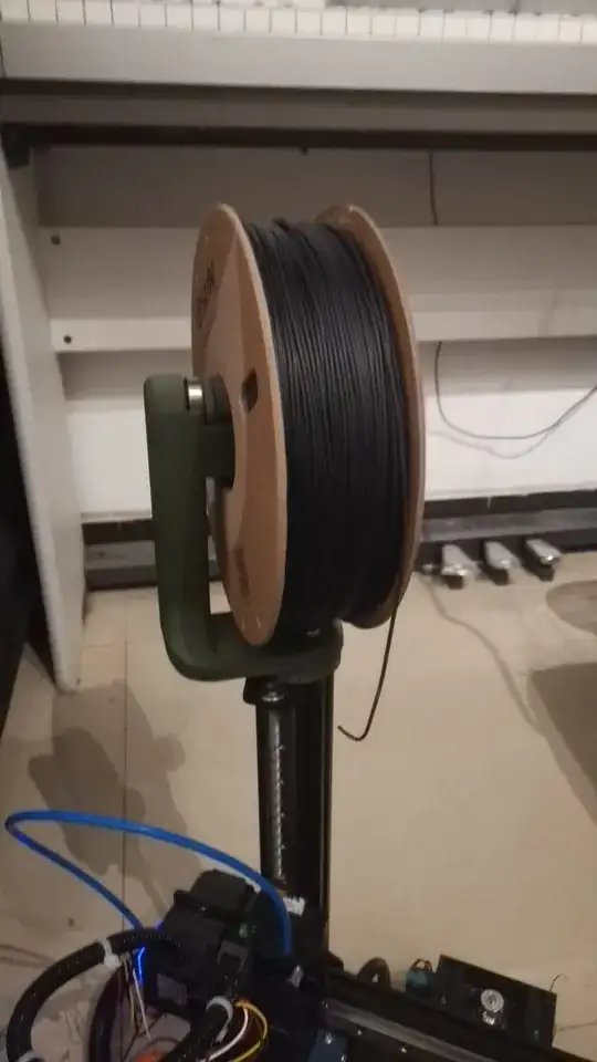

In order to lessen the mechanical strain on the filament I mounted it over the machine with a spool holder, and stopped using the filament sensor when printing my eSun eLastic TPE 83-A. I found this video, Kingroon KP3S Pro Top Mount Spool Holder in Detail , which uses a KP3S spool mount model which can easily be adapted to the KP3S pro.
Thus the filament feeds directly in the drive, and I have no problem printing this flexible filament.
Top mount for the filament spool
I may (or may not) explore a bit more in the future to see if I can tinker with the pressure of the filament sensor so that I can take advantage of it also with flexible/elastic filaments. But for now I will be printing flexible filament without using the filament sensor.
