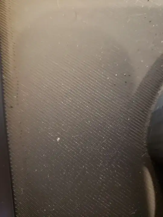

By rough, I mean there are visually distinctive diagonal lines (which are on all my prints, smooth or not, so I assume are normal), but dragging my finger over them is like dragging it over fine-grained sandpaper. Picture of Incarna_Tokens.stl with sandpaper bottom

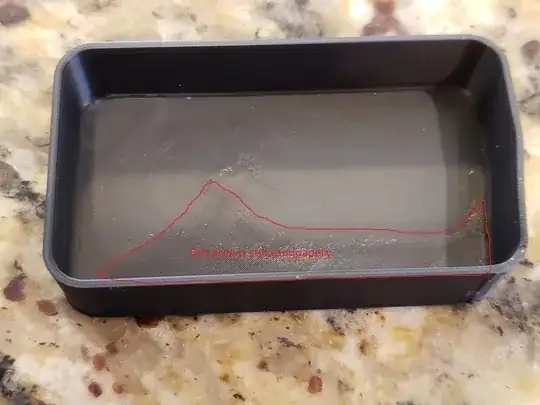

My tests consisted mostly of Incarna Tokens.stl -- this is the picture above. It's a mostly rectangular container to hold pieces for a board game, with a flat bottom that prints rough and walls.

  • I turned on ironing in Cura. This worked, but only sort of: 2/3 of the horizontal surface did not have diagonal lines and was completely smooth, a strip around the edges (the ironing offset) had diagonal lines but was still smooth, but 1/3 of the print still had diagonal lines and remains rough. enter image description here If the ironing completely worked it would solve my problem (I don't care about diagonal lines at the edges), but it only seems to be a 2/3 solution or so.
  • I adjusted ironing settings (following some page that I can't find anymore). I turned on monotonic ironing order, increased the line spacing from 0.1 mm to 0.2 mm, increased ironing flow from 10 % to 15 %, and increased ironing speed from 16.66 mm/s to 30 mm/s, then 50 mm/s, then 70 mm/s. None of these solved the problem that about a third of the print remained rough.

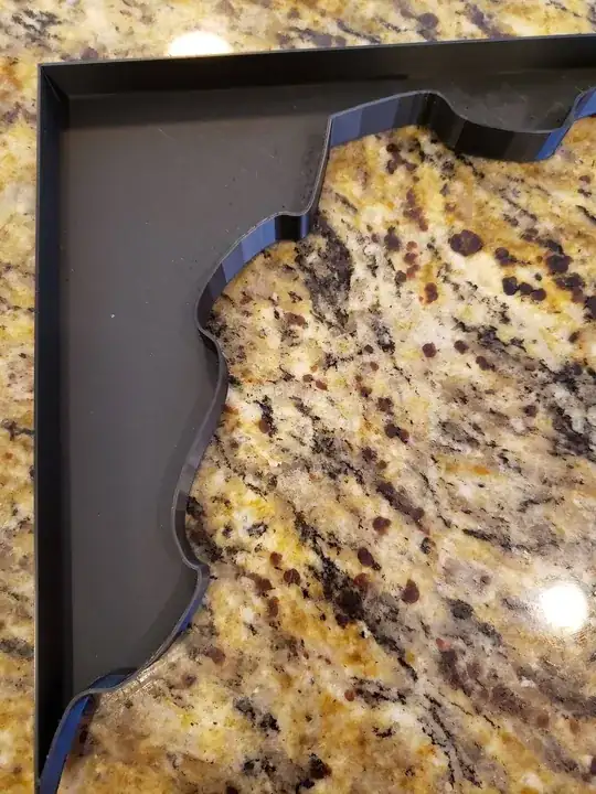

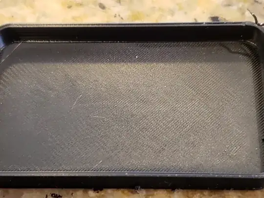

  • I printed some other prints. The default rabbit print the Ender comes with (no horizontal flat surface, just curved surfaces) prints fine. Small horizontal surfaces (the cube, all of these Gloomhaven standee prints) print fine -- diagonal lines but smooth to the touch. Larger horizontal surfaces (like Dahan_Tray_thin.stl) continue to print rough. Picture of Dahan_Tray_thin.stl Close up picture of Dahan_Tray_thin.stl I checked the large surfaces to see if they start smooth in a corner and then get rough, but no, the roughness is consistent across the entire surface.
I theorize, but do not have any experience to back it up, that this happens because the larger flat area means more elapsed time between layers, but even if that's true I don't know how I would counteract it. Looking at the closeup pictures, it seems like the line ridges are raised, but then why doesn't it happen on smaller prints?

Many Ender3 printers have a curved surface. Leveling is not going to fix all problems here. That is why you might have difference in thickness. Only a mesh bed leveling sensor is going to help here.
It looks like while ironing, the head extrudes a little too much material in the process. That way the extra material oozes out through the sides. You say that you tried increasing from 10% to 20%, so I would try it with 3 or 0%.
