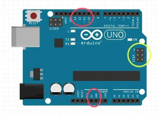

The pins on the Uno that you must use, are these, circled in yellow (you can ignore the red circles):
Uno board layout
The pin out is as follows:
Arduino Uno SPI pinout

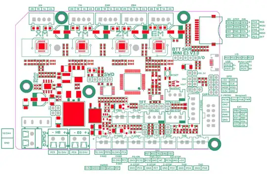

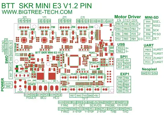

The pins on the BigTreeTech board are shown on the right hand edge/side of the board, half way down, where it says SPI1:
BigTreeTech board v1.2 layout
The SPI pins on the v3 version of the board are still in a similar location, but in a different order (along with 2 other pins, that can be ignored):
BigTreeTech board v3 layout
Connect these pins on the Uno, to the "like-for-like" pins on the BigTree - no crossing over of wires is required. So, connect:
  • MOSI to MOSI
  • MISO to MISO
  • SCK to SCK
  • RESET to RESET
  • VCC to VCC
  • GND to GND
On the V3 board ignore the additional NSS and 3.3V pins on the SPI1 connector
