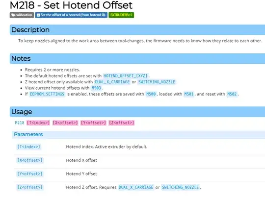

There is a specific code to set the offset between the various tools. This G-code is called M218 - Set Hotend Offset.
