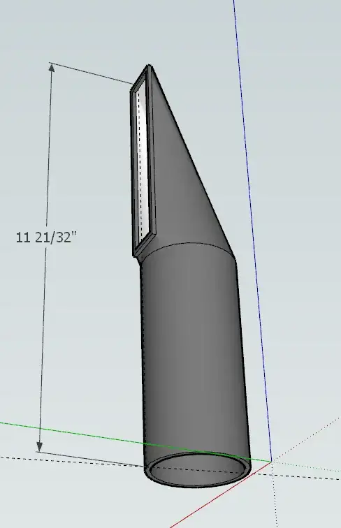

I am now trying to print a dust collector (hose) adapter that would connect my vacuum to my table saw guard. I have the model already (looks like below), I have managed to get quotes from 3D printing service providers so apparently everything looks OK
I still have doubts regarding the stability of the object during the 3D printing. How can I verify if everything is OK in that respect? I plan to print at our local public library which offers free printing (you pay the materials)
Here is my model, the OD at the base is 64.3 mm (2 17/32", the height is 288.1 mm):

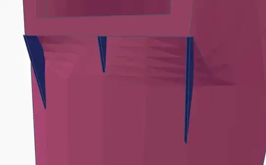

In the case of your vacuum nozzle, the overhang could be changed from the method presented in the video to a few gussets perpendicular to the surface under the overhang. This would "bookend" the overhang, creating bridging of the shelf, rather than drooping.
bookend shelf support image
This image above is a hastily thrown-together example of the suggested option. The difference between the left and right support panel is the result of sloppy and hasty creation on my part, not a reflection of the model construction.

The shape seems very easily printable.
The only part which will need supports is the bottom side of the rectangular connection port, in the figure just right to the quote "11 21/32". That part, if it doesn't need to be connected to anything else or doesn't need to be exactly horizontal, can be modified to be slightly slanted, see video below with the issue and solution.
Remeber that the height of the ramp depends on the depth of the overhang part. In the video the ratio is about 0.4 mm ramp height per 2.5 mm unsupported overhang. I would change it to be safer, 0.4 mm per 2.0 mm overhang, so (no less than!) 1 to 5. If your square connector is 5 mm deep (I mean measuring on the outer side of the opening, you get it), use a ramp 1 mm tall or more. The angle will be 11 degrees from horizontal.
Printers may struggle when the angle from horizontal is less than 20, but it's worth a try... or simply make it a bit taller, 0.4 mm per 1.5 mm overhang.
Once printed, file the ramp out so it becomes horizontal again. Try to use ABS if you can, it does better overhangs than PETG. PLA may work too but it's quite brittle if you hit it.

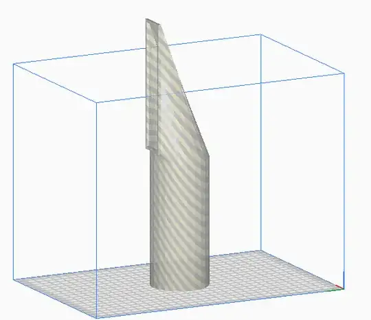

From the mentioned printers, none of these allows for the tube to be printed upright, the TAZ has the largest height of 285 mm (depending on the exact version they have), your object is 288 mm...
e.g. One of my printer cannot take the object upright: enter image description here
This means that you are left to two options, cut the object into two pieces and design a coupling between the two pieces, or you need to modify the orientation of the object.

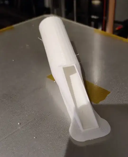

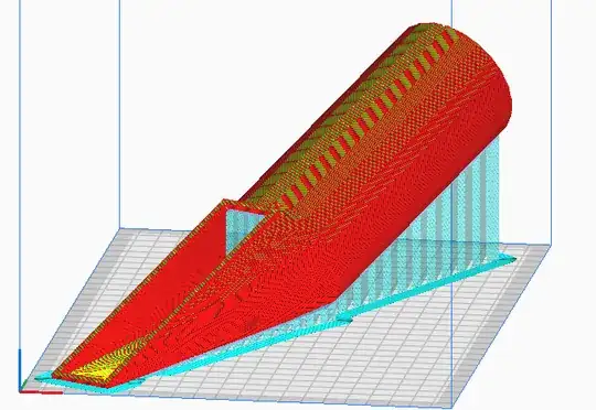

E.g., you could print the tube other than upright, see below (it fits my 200x300 mm printer):
This is sliced with support, but, a smaller scaled version printed fine without support. The larger version and the shallow incline of the tube need support for the full size print.
Scaled version of the tube printed without supports: enter image description here
I think the best solution is to break up the part into two pieces and design an appropriate coupling. This would give you 2 parts, but the printing time and the amount of support will be minimum. The less time and the less support the higher the chance the parts print in one go without failing. It is also best to print the two parts after each other, else you will have the nozzle to retract (takes time) in between the two parts if printed together.
