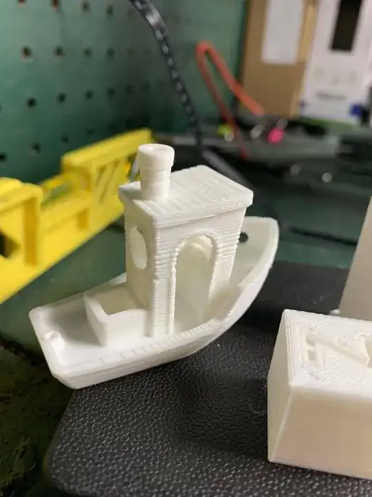

Anyhow, it caused this kind of print:
3D benchy with printing errors
There are a few angles where it actually looks pretty good. The hull is fairly smooth, the first layer went down well, the roofs and bridging look tolerable, but as you can see, especially around the "pillars" it looks I don't know... under-extruded? Like the lines don't connect very strongly. In fact, it might be hard to tell from this photo but the bottom actually ripped off when I took it off the plate, mostly due to weak connections between each layer.

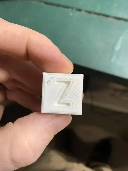

  • I did the baseline print. My first one looked like the top of the cube had some under extrusion (you can see through it if you look closely in this photo enter image description here
  • I did the slicer flow calibration and actually it came out a little tiny bit too big (which would indicate I need to turn down the flow), but as Teaching Tech mentioned at the bottom of the page, you can't always trust that so I didn't end up making any changes to flow.

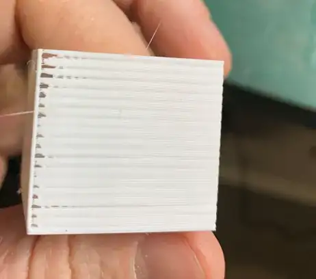

    • Worth pointing out, in this photo of the Slicer Flow calibration cube, you can see some weird holes where the nozzle would be kinda late starting a line. enter image description here

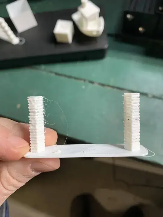

  • At this point I felt like retraction tuning was the problem and would fix everything, but with the default speeds in Teaching Tech's sample print, distances from 0-8 mm didn't seem to do anything differently in this print: enter image description here

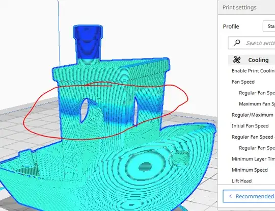

It's got to have something to do with under-extrusion or flow. I think I ruled out the Z-axis. I made a "tall" benchy by modifying the benchy file to have a platform underneath it. This bumped it up a few cm and the problem still happened in the same spot on the pillars of the benchy (which is now in a completely different spot on the Z. Also, given the "flow" preview in Cura: enter image description here
That circled low flow area is where it always messes up.
So now to figure out why it's got low flow. Again, I calibrated the E-steps and it seems to be accurate. I've also printed benchy's where I told Cura to have 110% flow just to check. The last one I attempted didn't just fail, it failed big time and became a blob at that same spot.

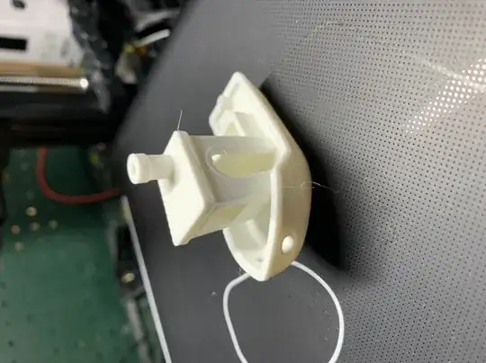

enter image description here It was a worn extruder gear. I didn’t think it was THAT worn, and when I loosened it a bit and slid it a few mm so that the gear hit the filament in a fresh spot it didn’t improve. But new stainless steel gears showed up today and when I installed one it worked perfect. Same file/settings/gcode that had failed several times previously when testing other things

I see positional errors in X and Y, but Z looks okay.
That suggests one or both of your belts is stretched, perhaps damaged, or maybe just loose.
Try engaging the stepper motors in the device's panel and push the head left/right or pull the bed toward/away from you. They should both resist handforce, and you then feel like it needs to be pushed with full arm/shoulder force to move it (but don't actually force anything with that level !!)
There should be none/almost no play in X or Y with the steppers locked/engaged.
Then disable the stepper motors in the same menu, and both bed and head should slide with one finger's push.
This test does not work for Z but that axis seems fine in your benchy print.
Also check the condition of the drive/tension pulleys at either end of the belts. There should be no powdered plastic from the cogs, nor rubbery bits from the belt.
I cannot see any over/under extrusion, so the extruder/drive is probably okay.
