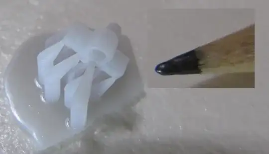

Today's hobby grade resin printers are capable of amazingly tiny detail. The hole is about 1.5 mm diameter, and the pencil point in the photo below is of the same scale as the part. It was farther out of the frame and composited in to provide a better reference.
This part was constructed on request of a train aficionado desiring to have hinges for the freight cars he was building.
door hinge image
Details that are not holes would be more easily accomplished. Depending on the orientation of the figurine, you can get between 0.037 mm and 0.050 mm resolution. This is due to different resolutions in the x/y plane and the z-plane. If the figurine's feature was vertical, the z-resolution could be 0.050 mm but the x/y resolution would be 0.037 mm.

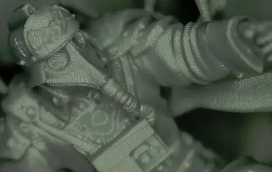

There's a great reference page from Chitubox describing the different technologies as well as a couple photos.
0.047 mm resolution image This image is of a model constructed with 0.047 mm resolution. The following image is of a model constructed at 0.100 mm resolution.
