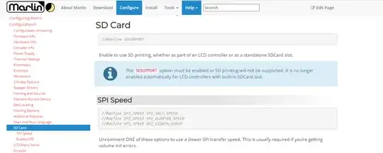

I had previously asked this question here and most of the suggestions were to "take it out and plug it back in again" or to get a new sd card. I've tried it with new, name-brand (Sandisk) cards, and it doesn't work any better/worse than the card that came with the Ender. I've seen various suggestions around the internet (like on Marlin's website) that adjusting the SPI speed can possibly help with "Volume Init" errors, which I assume to mean the same thing: enter image description here
I have tried the firmware at both normal speed and half and quarter, haven't tried eighth yet. I didn't notice any different behavior for any of them.
