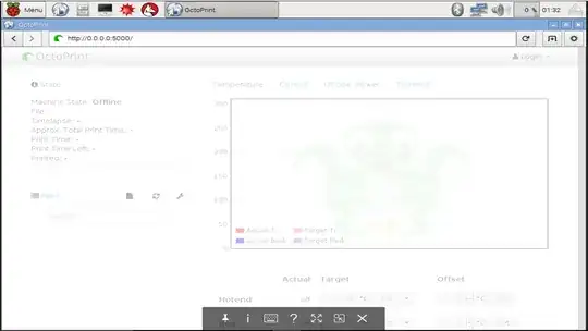

The webpage of Octoprint freezes
I don't know if this is fixed in later commands, but I would like to get a sense of how all fits together before continue. It doesn't look that is the browser (I am capable to visit other websites without any problems), so is maybe Octoprint? How can I fix this? Did anyone have this problem before? Thanks in advance

Is it the Raspberry Pi that locks up, or just the webpage? If the whole thing becomes unresponsive I would consider reviewing your overclocking settings. If you've set one of the higher overclocking values in the config script, this can often lead to random lockups. If you don't see the config script every time you boot the Pi, you can access it by typing the following into a terminal window.
sudo raspi-config
You can find out how to change the overclocking settings from the config script in this guide
